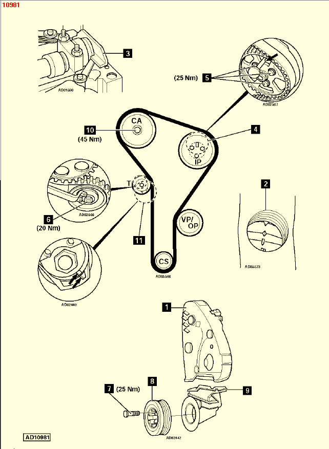

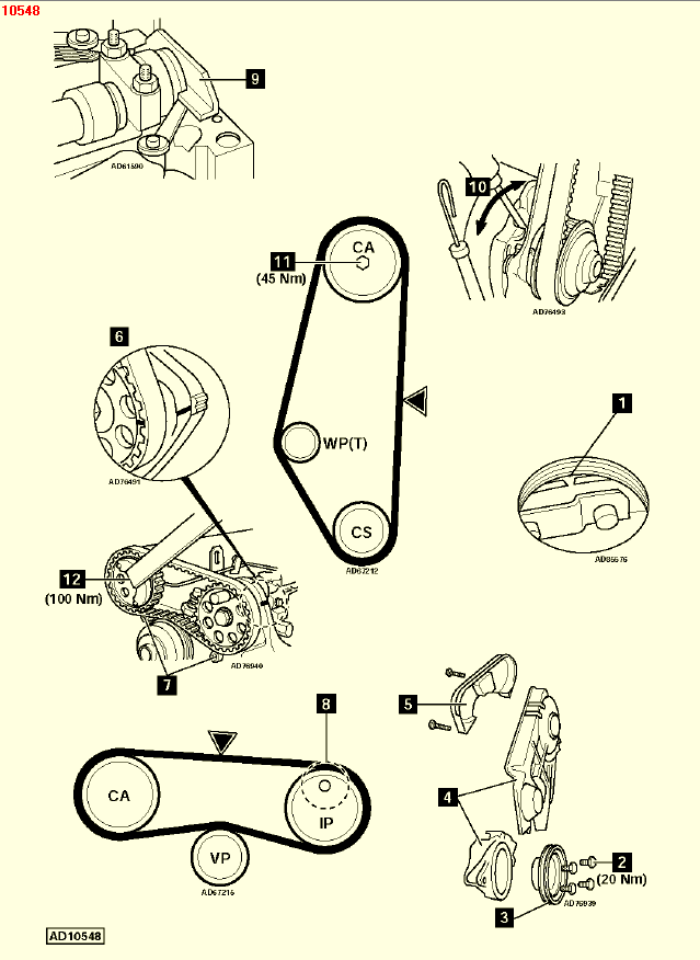

(86-90) 1.3D MN, (90-94) 1.4D 1W

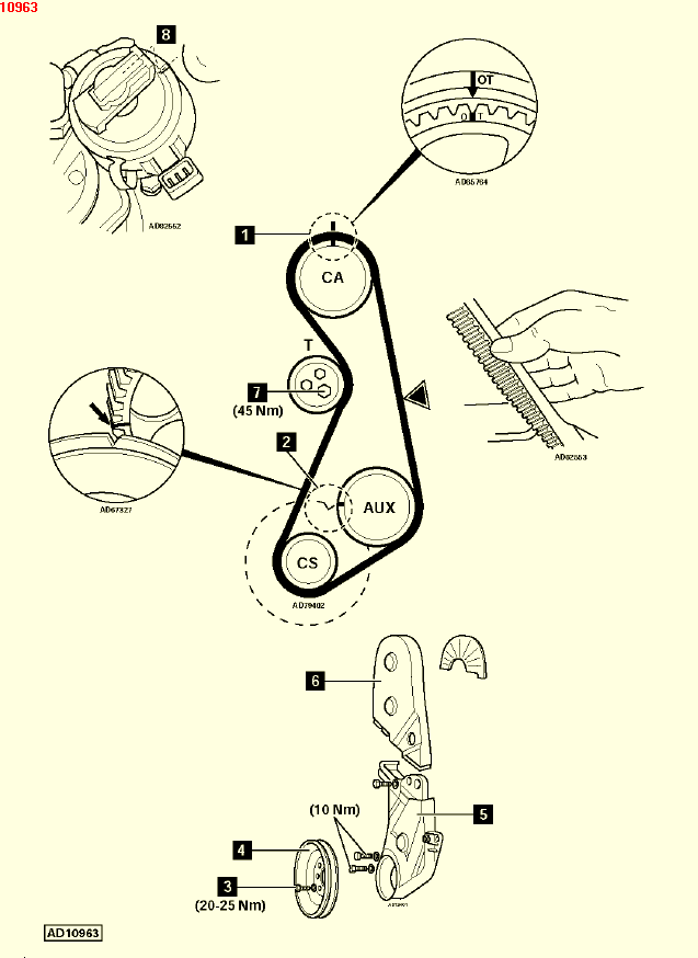

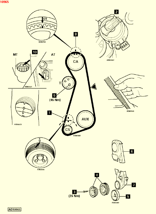

(94-02) 1.0, AER, 1.05 AEV, 1.3 ADX, 1.4 AEX, 1.6 AEA, AEE

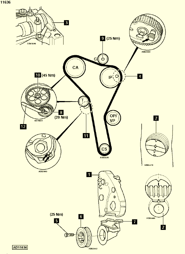

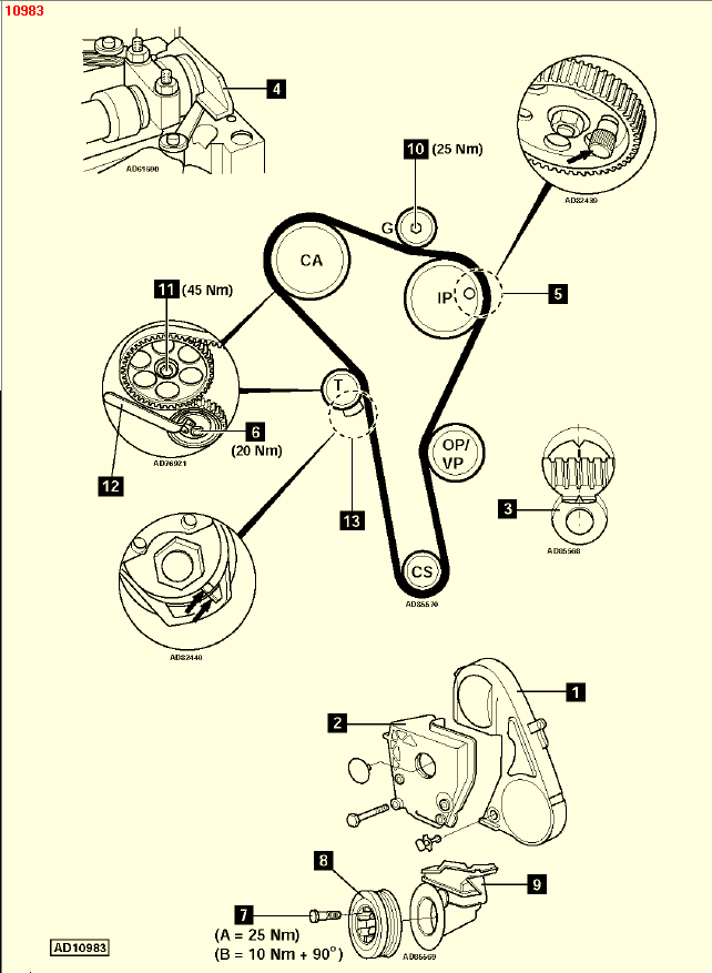

(95-00) 1.9D 1Y
(95-00) 1.9D AEF

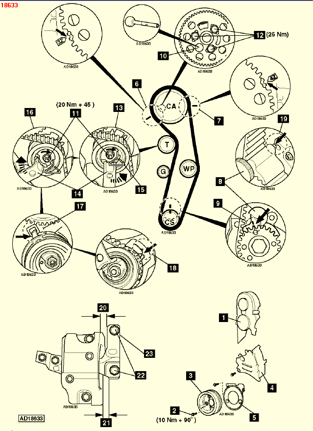

(96-02) 1.7D SDI AHB, 1.9D SDI AEY

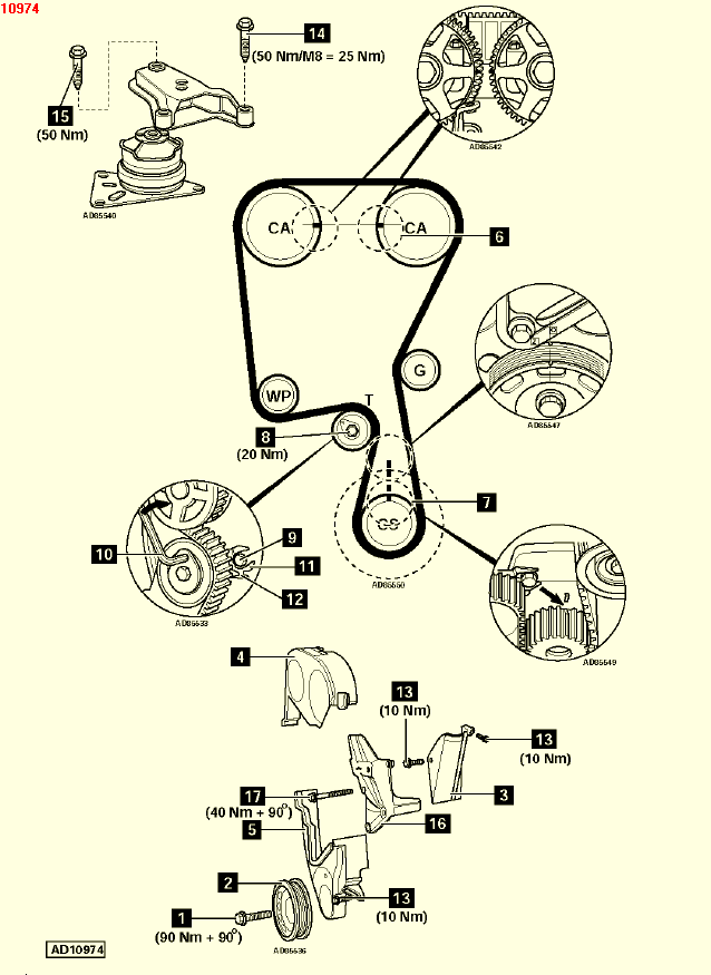

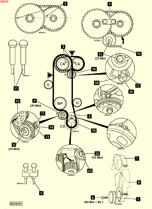

(98-05) 1.4 16V AHW, AFK, APE, AUA, AUB, BBY, BBZ, 1.6 16V AJV, ARC

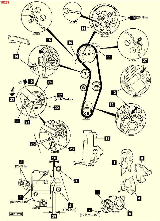

(99-02) 1.4 TDI PD AMF
(02-06) 1.9 TDI PD ATD, AXR
